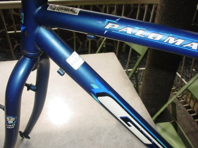

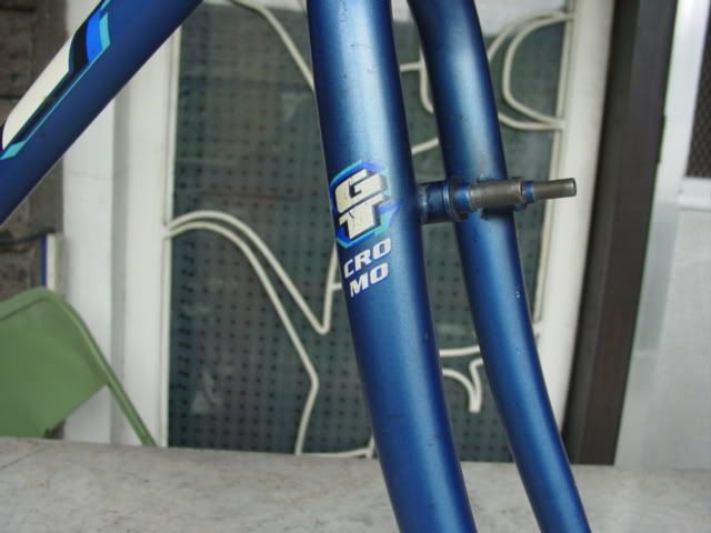

i have a old school gt palomar which came from japan. cromo all the way even the fork. i just need suggestions for my set up here are some pics.
what i have in mind is weight weenie wheelset. decent components and SS converter for the meantime while i save up for the SRAM drive train.
my fork is threaded that's my problem. is there a converter so i can use a threadless stem? help please thanks

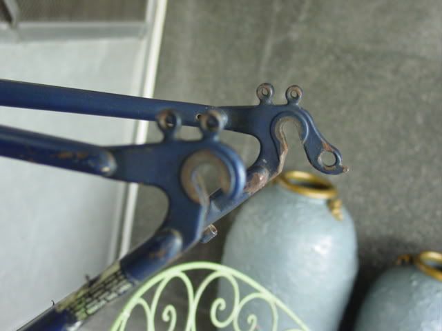

Bro patingin nun drop out... Very Happy
Yung fork ba nya is 1 1/8 na threaded or 1 inch lang? meron ako sa bahay 1 1/8 quill adaptor para magamitan mo ng threadless stem yan (pero gagamit ka pa din ng threaded headset)
Ganito itsura
Bigay ko na lang sayo, pero sure ako 1 1/8 yang fork mo so sakto.

hope it's 1 1/8 Smile do you plan to use the rigid fork?

@ryanusuke sir il take a picture later and post it hehehe its the normal dropout sayang nga hindi pang ss eh heheh its 1 1/8 nga kasha yung lumang suspension fork ko eh.may nabibili pa ba na threaded na headset?
Sa mga local bikeshops siguro may mga theraded na headset heheh yung maganda na rin sana quality heheh

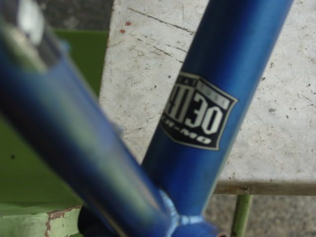

@sup yes i plan to use the fork para gt all the way hehehe STEEL is REAL.... heheh sarap ng laro ng cro-mo heheh 4130 pa so hindi ganon ka bigat eheh

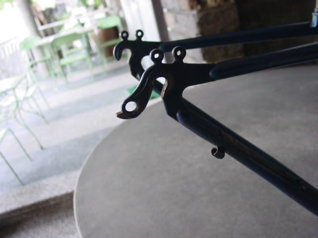

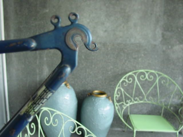

updating pics with drop outs, mejo may kalawang heheh pero ayus lng eheh

looks like your dropouts are semi vertical. there's a chance you could go tensionerless! good luck! Smile

measure your headtube! mukhang tama si ryan na 1 1/8 yan.. hope you could find a headset for it.

tanong lang...
sa old school frames, ano ang gamit nung 2holes sa dropout? Rolling Eyes
sa Raleigh frame ko noon kasi...
sinisingitan ko ng plastic na para tunog ringle....
Laughing

rear rack? yihheee, gusto mag touring bike! What a Face

kulot, design yata yan para mag mukang mata ni gary ng bikini bottom. hahaha! Very Happy
di ba para sa support ng rack/pannier sa likod.

NgiyaWW! hehe...Support nga po sa pannier, ni shave ko yung ganun nung steel frame ko.

@duds- im also currently restoring an old DB crmo bike. am in the process of scraping off the old paint so i can have the frame powder coated. mukhang standard naman head ng frame mo. madami pang mabibiling threaded headset. may nakita pa nga akong XT. kung gusto mo ng threadless may nakita ako mga tange saka aheadset.
bakit mo gusto gamitan ng adaptor saka threadless stem? hindi kaya mas mabigat pa yung may adaptor kesa yung standard stem na alloy? may mga nakita din akong attack racing saka control tech na old school stem. ganda!

@vwbeettle meron nga ako sir pang threaded na headeset stem na kore kaya lng dami na gasgas hehehe pero pwede pa siguro irestore ehehe. headset na threaded nlng kailangan ko. wala pa budget parepaint eh heheh. gamitin ko nlng muna as is Smile thanks sa mga suggestions and opinions mga sir.

try to look if you can find the magic gear para wala tensioner or use a half link. un mga old frames kasi usually sakto un chainstay length to go tensioner less.
re: the fork, yes threaded headsets are still available, try decimal in quiapo, bought one there a year ago, tange ...made in japan or you can convert the fork to a threadless one. reminder you have to cut all the threaded section of the fork and have the extension welded. un section na un kasi ang nababali sa mga converted forks.
re: the paint... just clean the frame and touch up the exposed parts with nailpolish or have a painter retouch the rusted portions or just clearcoat the whole frame with a satin finish. personally i would just leave the paint as is, just retouch the exposed parts... mas retro looking at orig... may battle scars k pa na maipagyayabang. good luck on your build. Very Happy
