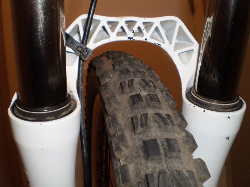

man, its the same spot where the other fork broke. im pretty sure rockshox botched up the 2010 boxxer forks, hehehe.
that is so pathetic. that part is so elementary. sobrang nipis ng ginawa nila, hehehe.
nice going fox. you've pushed the envelope of engineering way too far for the other for manufacturers to keep up, hehehe.

jon, baka nasakal ng zip tie.

jaymz wrote:jon, baka nasakal ng zip tie.
nyahahaha. yung nga daw yung sabi dun sa kabilang forum na pinagkunan ko nitong pic eh.
pero mukang may bubbles ng koti sa loob ng bakal. mukang defect sa casting nung arch/lower legs. so dapat asikasuhin ng rockshox yung quality and control nila. di maganda, hehehe.

pansin nyo at the back of the arch is may mga hollow tabs to reduce weight. Yung earlier boxxer wala nito as in solid talaga.
Sayang, gusto ko pa naman ng 2010 boxxer. Wait na lang ako ng 2011, kung may changes....

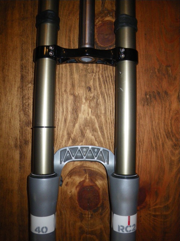

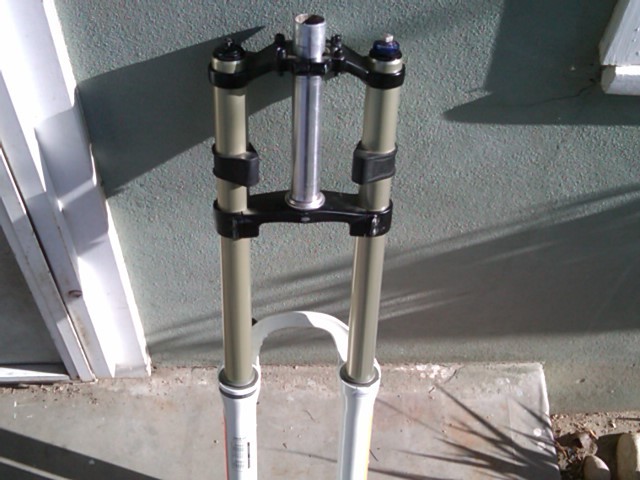

just to add din sa post si sir ian,
'08 WC Boxxer
eto po ang arch ng 08' zoki 888
eto nman sa pax40 na '07 / '08
malapad sila, compare sa new boxxer

they made a carbon fiber version of the dorado. tapos ang usapan. hehehe. mukang ayaw ng kumita ng pera ng manitou, hehehe.
in fairness, yung XC fork nilang R7 na lang nila ang medyo nananalo sa mga races like the last adrenaline 24hrs race, gamit nung rider R7.

s session 88 tama darkman its for FRO frame.. they made it light so accept d consequence.. so ingat lng talaga.. dapat lng kasi ang mahal..
s boxxer.. sram dapat gawa sila solution same location ng arc damage.. yez weak ung area n un.. i hope sana s akin ndi.. ang mahal eh.. for next yr may improvement n yan arc..
doon s pix posted ni ato.. unang pix.. coz ng failure eh wheelset.. buti n lng ndi ako nag dt..
s inverted forks.. yez prone s twist @ un-stable daw [flexy s turn].. no idea dun s gawa ng foes [inverted fork din sila].. mukhang matibay un kasi ang laki kya laki din presyo..

kagabi habang binubuo ko ung bike ko s kwarto.. pinagmamasdan ko ung arc ng boxxer.. why, bakit, paano, what.. 330am n naka sleep
pansin ko lng ung area kung san naglalagay ng zip tie.. kita s pix.. ung part n yan may tendency n bibigay.. lalo kung hindi maganda ung endo landing.. ang arc ng 2010 boxxer sa tingin ko lng kahit gawin nilang solid ung area n yan bibigay p rin dahil s impact.. medyo manipis eh.. ung engineering contruction nyan dapat e-beefy konti.. wag n nilang isipin n mababawasan o madagdagan ung weight.. habol dapat nila dito ung safety opcors riders syempre.. so dapat ung area n yan patibayin dahil prone sa successive impacts..
eto ung sram.. paramihin muna nila ang ganyan problema tsaka nila review ung engineering construction then yon na..

honga, nabasa ko sa mga forums abroad na kapag may lumabas na bagong generation na mga rockshox, wag muna bibili sa unang taon, hehehe.
at ang rock shox boxxer ngayun ang may pinaka maliit na diameter ng stanctions sa DH forks ngayun:
fox = 40mm
marzocchi 888 = 38mm
manitou dorado = 36mm
rockshox boxxer = 35mm
sobrang pagpapagaang nila, pati yung arch tinipid nila, hehehe.
fox = 40mm

malamng maglalabas ang sram ng boxxer recall.. depending s serial/code ######.. if talagang they found out n itong serial/code n 'to may engineering contruction material defects..
