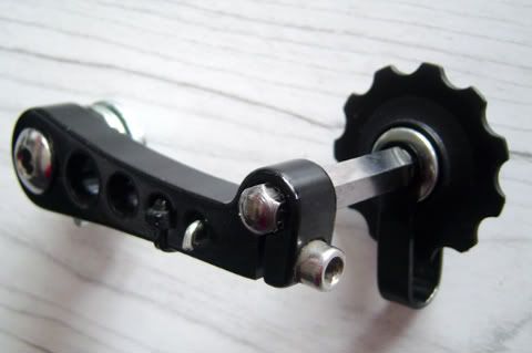

Post by primera on Wed Aug 12, 2009 3:14 pm
Good day sirs, newbie to SS here, i'm planning to purchase this tensioner because it's one of the cheapest branded tensioners out there, are there any issues re this tensioner that i need to consider? Will it serve me well base on my budget or do you think in the long run i'll save more if i get the more expensive ones like the fireeye or surly?

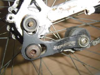

Post by maxbuwaya on Thu Aug 13, 2009 2:55 pm
Bro, ito yung akin ha? Just to make sure Smile
RL-4

Meron ako dalawang da bomb tensioners as pictured above. Drawbacks, nawala ko pareho yung mga bolts...hehe lol! . Yung isa nabarag na yung polyurethane wheel, naiwan yung bearings...ang ginawa ko, gumupit ako ng lumang cheap grips, sakto naman...ganito naging itsura after mawala yung bolts tas masira yung wheel. rabbit
